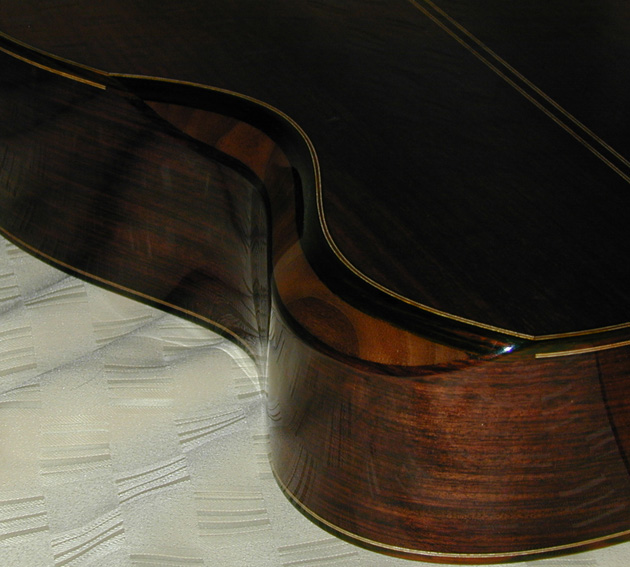

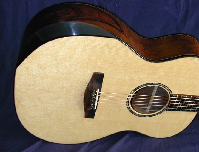

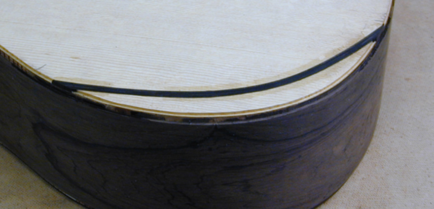

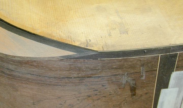

Here is one I did a couple years back - the customer wanted it to be all black, just morph out of the binding with no continuation of the purfling lines on the top edge. I dont purf the side edge at all anymore - the only real way to cut the troughs is by hand and it can be a real bear. So now I do them this way, or not at all !!!

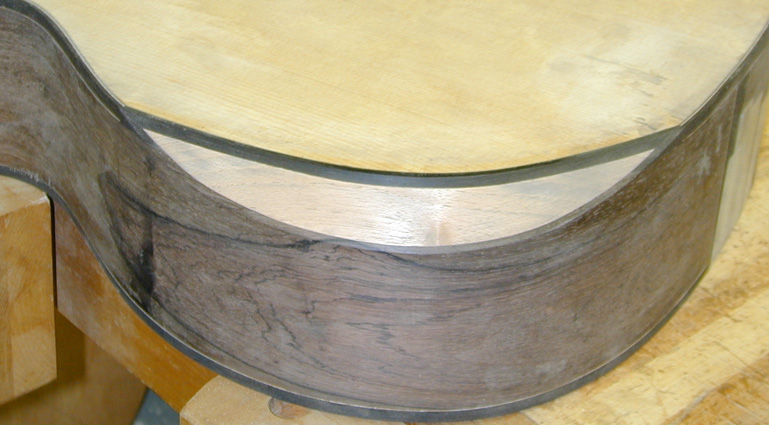

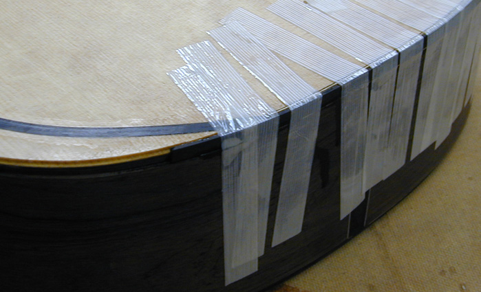

you will note in the one photo aways down how the ebony doesnt end nicely at the corner of the armrest smile as I call it. this is because the top binding is only about 1/32 deeper than the top thickness. This doesnt happen at all if the binding and back and sides are the same wood - thats actually how I prefer to do them if I can, otherwise I usually end up darkening the armrest, or lately I actually came up woth antoher way, which is to bind the top of the armrest at full binding plus purfling depth, then it just carves right into itself all at the same level. So anyway here are some photos - the first one shows that I cut all the binding and purf channels first, all the way around. The internal block is sized to be a bit bigger than the plexi template I use to route for the ebony binding shown inlayed here.

There were three pieces of ebony used to fill the channel in the previous shot - here I show how the binding overlaps the end of hte armrest - the side purf was stopped, and I filled the end void with a sliver of ebony
PostPosted: Tue Jan 10, 2006 9:05 am
The side purf was actually stopped at the point of the armrest, where if there was a top purf line, the mitre would have been. I have also recently modded the template used to route such that the transition is smoother, not requiring a mitre on the top purf anymore.
PostPosted: Tue Jan 10, 2006 9:08 am
So, once all the binding is glued on, you can carve in the armrest, making sure not to carve deeper than the internal block you made - keep notes before you glue it in, make a tracing of its shape, I always do. Then, once this one was finished and blacked out, it looked like this.
PostPosted: Tue Jan 10, 2006 9:10 am
Oops had one more photo than I thought - the above shot shows how the binding looks when the binding and the side wood are different - if this guitar was bound is a brown brazilian, the armrest would have been nicely framed in, and the rest could have been left natural. Here is the finished shot.

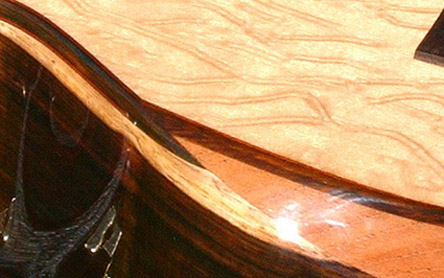

If you want to see one done in mathcing side and binding, with a spanish cedar armrest blcok, ther is this look in natural ...

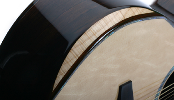

Here is a ribrest, natural, rest is black walnut, where the binding is dark brown braz on ei rw sides. The binding for the ribrest was done full height -ie, I cut the channel on the rest as deep as the side binding ledge was, so the binding depth looks continuous around the rest.
PostPosted: Tue Jan 10, 2006 9:22 am
Here is an armrest, done in curly maple, where the sides and binding are braz - this one was done exactly like the top set of photos using the ebony, so you can see how the corner of the smile trims out nicely when the wood is all the same - frames the rest block in really sweet.
